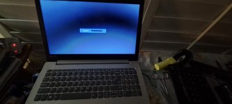

Hi - is there a way to unlock the bios? I got a replacement motherboard from vendor but it has bios lock. Please advise - and thank you for your site.

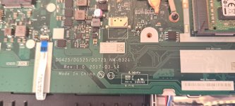

Holden53
Lenovo Ideapad 320 - 15AST Type 80XV
Lenovo Board: LNVNB161216 / SDK0J40700WIN
Current Bios 5pcn24ww 10/29/2018

Hello! I recommend you to program Bios first! If it asks password again, try to reprogram IO ( ite bin file )

At the end of this journey is this: I had a 2nd damaged 320 board and followed a guy on YouTube that de-soldered using flux only and re-soldered using flux only. I removed the bios chip off that damaged board and installed it on this locked 320 Lenovo Ideapad AMD and I am in the bios! - I just stopped in to thank all of you for trying and I learned some good things here by stopping in and subscribing to your website - Thank you all for taking the time to try and unlock the 320 - My bios clip has not arrived yet so I went through this process just to see if it would work. I had nothing to lose - Thanks again - !
