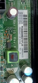

hi
please bin file hp 600 g1 tower
  • 600g1rakha.BIN
eslam-power
iam check hardware
my old file working logo hp only
but your file power but no data
plz i need another file
after 5 second restart and start after 5 second restart
but last file working normally but no internet
if bios works normal and only problem is internet then i think problem is not from bios
try new windows or driver pack
eslam-power
i tried another hard new window but same problem
in bios menu mac address became ff:ff:ff:ff:ff:ff
search in google for resolve Mac Address in bios
i think you should insert new Mac Address for device
