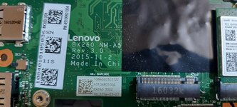

hello please i need the patchess for lenovo bx260 nm a531 rev 3.0
Model x260
I attach the old files
  • LENOVO BX260 NM A531 REV 3.0 OLD.bin
"Instructions for use"
Remove all battery and CMOS battery
press F1 to enter setup: password 1234
wait 20sec or more.
Enter any ID to hardware Id.
Press 2x space bar when asked.
Turn off the computer.
and restore your original bios .
Enjoy.
If 2x 5beep, it's normal.
I didn't do checksum but it must light up anyway.
Wait minimum 30sec before screen logo light on. Must turn on/off several times by itself.
  • LENOVO BX260 NM A531 REV 3.0 OLD_PATCHED.bin

C'est bon sa marché cette fois-ci
Merci beaucoup
